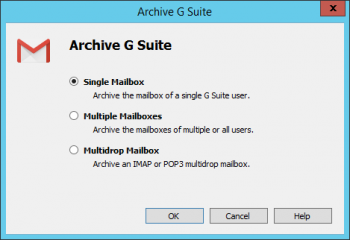

- Click on Archive Email.
- From the Email Servers list in the Create Profile area of the window, select G Suite to create a new archiving profile.
- A wizard opens to assist in specifying the archiving settings.
- Select Single Mailbox and click on OK.
- Select Multiple Mailboxes and click on OK.

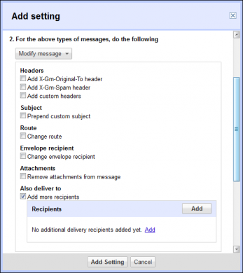

Step 1: Configuring email forwarding for a G Suite email domain
Please proceed as follows:
- Log on to your G Suite domain as an administrator.
- Navigate to Apps > G Suite > Settings for Gmail > Advanced settings.

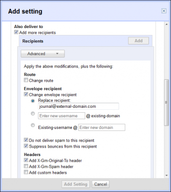

- Configure Receiving routing:
- Under Also deliver to, activate the Add more recipients option.
- Select Advanced and activate the Change envelope recipient option.
- Enter the email address of the multidrop mailbox into the Replace recipient field.
- Activate the Add X-Gm-Original-To header option.
- Click on Save further down the window and then on Add setting.

- In MailStore, click on Archive Email.
- To create a new archiving profile, select G Suite from the Email Server list in the Create Profile area of the application window.
- A wizard opens guiding you through the setup process.
- Select Multidrop Mailbox and click OK.
- Enter the email address of the MailStore Gateway mailbox into the Replace recipient field.
