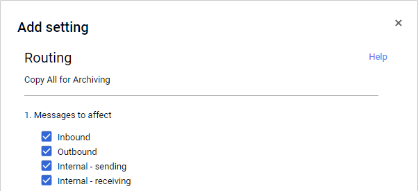

  • Click Configure or Add Another to create a new routing rule. A new window appears.
  • Enter a name and enable all checkboxes in the Messages to affect section.

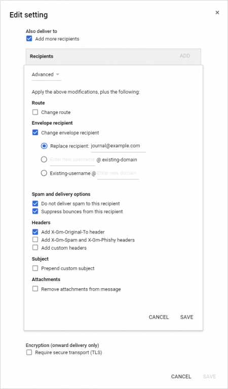

  • Under Also deliver to, activate the Add more recipients option and Add an additional delivery recipient.
  • Select Advanced from the drop-down list.
  • Activate the Change envelope recipient option.
  • Enter the email address of the MailStore Gateway mailbox into the Replace recipient field.
  • Activate the Suppress bounces from this recipient option.
  • Activate the Add X-Gm-Original-To header option.
  • Click on Save further down the window and then on Add setting.
