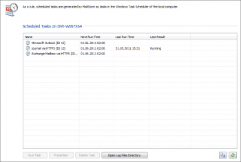

| + | == Managing Scheduled Tasks == | ||
| + | Scheduled tasks created on the current computer are managed in Administrative Tools under Scheduled Tasks. | ||
| + | [[File:arch_schedule_02.png|center|350px]] | ||
| + | The list shows all scheduled tasks for archiving and export processes that were created on the current computer. | ||
| + | Run Task: The selected task is executed immediately regardless of its scheduled runtime. | ||
| + | Properties: The Windows task planner is opened for the selected task; all options offered by the current Windows version can be used. | ||
| + | Delete Task: The selected task is deleted. This does not affect the underlying archiving profile or any of the archived emails. | ||
| + | Open Log Files Directory: The directory containing the protocols for the selected task is opened. | ||

A list of scheduled tasks is displayed in MailStore's Administrative Tools, showing all tasks created on the current computer up to this point.
Open Log Files Directory: The directory containing the protocols for the selected task is opened. Viewing the Command Line
